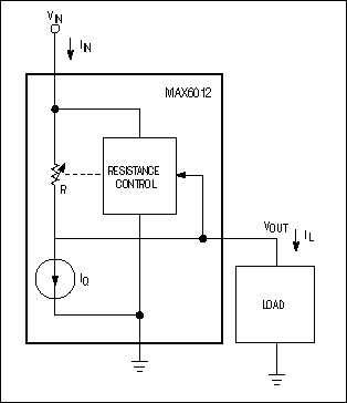

The series reference operates in series with its load (Figure 2). You can view this type of reference as a voltage-controlled resistance in which VOUT controls an internal resistance between the reference's input and output terminals. A series reference regulates by creating a voltage drop between its input and its output equal to the product of load current and the controlled internal resistance. With no load, the series reference draws a small amount of current, IQ, through the internal resistance, R, to drop a voltage between input and output necessary to produce the correct VOUT.
Figure 2. The regulating part of a series reference connects in series with its load.
As load current increases, the reference maintains the desired output voltage by changing R as necessary to produce the correct drop between input and output. Applying Ohm's law, you can see that, to maintain a constant drop between input and output, R must decrease as IOUT increases. The appendix "Popular Voltage-Reference Types" highlights the major pros and cons of the common types of shunt and series references.
