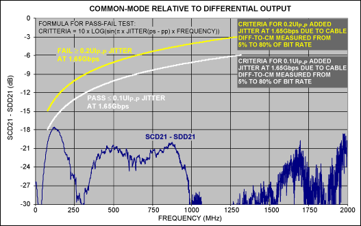

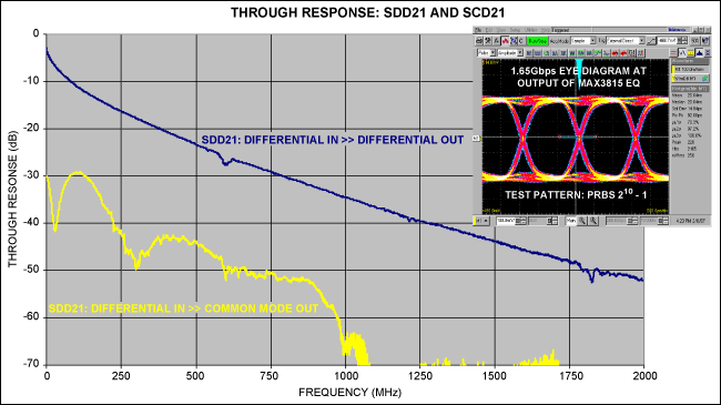

Figure 7 shows the common- and differential-mode responses of a cable, and Figure 8 plots their difference, showing common-mode relative to differential-mode outputs. Figure 8 also includes templates for 0.1UI and 0.2UI (lines of constant error in the differential zero-crossing TJ[pk]), where UI is the unit interval for the bit period at the given data rate. For example, the 0.1UI jitter line calculated for 1.65Gbps (WUXGA) represents a constant maximum zero-crossing error of 60psP-P.
More detailed image (PDF, 314kB)
Figure 7. Frequency response of a 60m cable, showing common-mode output (SCD21) and differential-mode output (SDD21). Data is gathered on the MAX3815 TMDS digital-video equalizer.
Figure 8. Plot of (SCD21 - SDD21) difference, with pass/fail template superimposed.

If the cable measurement in Figure 8 (SCD21 - SDD21) reaches the 0.1UI line at any point, cable imbalance creates a potential for 0.1UIP-P jitter. That is, if a spectral component in the data-signaling sequence coincides with a frequency at which the cable measurement touches the 0.1UIP-P template, the zero-crossing error (phase-shift range) for that spectral component is 0.1UIP-P (60psP-P).

Figure 9 shows a simplified pass/fail template, derived from the formula in Eq. 2. The 0.1UIP-P template is -11dB from 0.05 to 0.25 times the maximum bit rate, and a flat ramp up to -6dB at 0.8 times the maximum bit rate. The template simply scales with the maximum operating bit rate specified for the cable (1.65Gbps, in this case).
Figure 9. Simplified test template, for which 0.1UIP-P pass/fail criteria are recommended.

Appendix I: Real Cables Tell the Story
More detailed image (PDF, 298kB)
More detailed image (PDF, 297kB)
More detailed image (PDF, 313kB)
