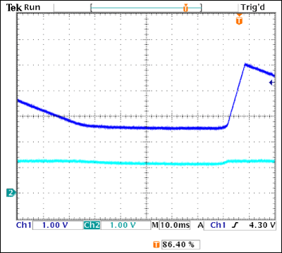

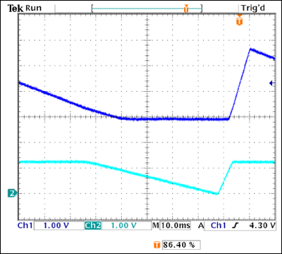

The oscilloscope traces of Figures 3 and 4 compare the original Figure 1 circuit with the improved version by monitoring test points TP1 (top trace) and TP2 (bottom trace). Both signals are 1V/div, and referenced to ground potential.
![Figure 3. As TP1 in Figure 1 (top trace) decreases, indicating an open in the LED chain, the bottom trace (TP2) is hardly affected, and therefore produces no fault alarm.](/article/UploadPic/2011-1/20111213430197.gif)
![Figure 4. As TP1 in Figure 2 (top trace) decreases, indicating an open in the LED chain, the bottom trace (TP2) also decreases, until the IC senses the low voltage that indicates an LED fault.](/article/UploadPic/2011-1/20111213430772.gif)
As an open LED (or a lower supply voltage) causes the the top trace to decrease, the transistor eventually saturates, as indicated by a flattening of this trace around 2.7V. The bottom trace in Figure 3 is hardly affected because the the base-emitter diode of Q1 supplies the 20mA load current. Fault detection is not active. In Figure 4, the bottom waveform also decreases as Q1 hits saturation, thereby activating the fault circuit as the waveform falls below the 200mV threshold.
